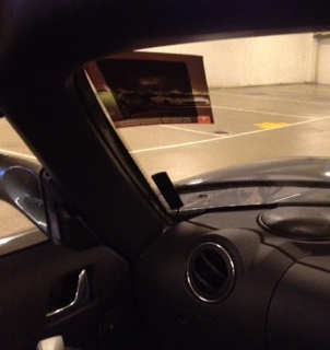

The solution we found is a short flat adhesive antenna specifically designed for in-vehicle applications. The cable runs through the fuse box area of the car, and down to the passenger foot-well. It is not too difficult to lay this (once you know how).
Of course, you can decide for yourself where to put this, but in the lower corner of the windscreen it is fairly unobtrusive and the cellular signal using this is dramatically better than the stubby little antennas we were using before.
