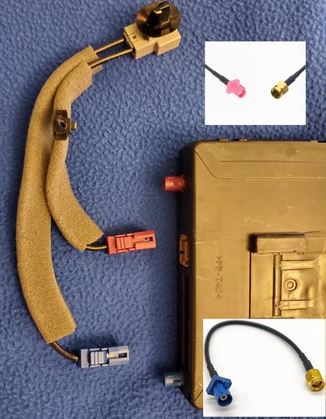

I had no problems with using
I had no problems with using the existing antennas. My US 2017 TCU has male FAKRA C and H connectors for the two antennas. FAKRA male to SMA male cables are available from multiple vendors. I got both for $9 total on eBay a few years ago.
