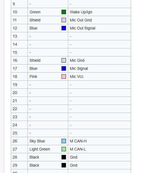

This is for a US 2017 SL with premium. The 2016 should be pretty similar, but it's a good idea to obtain the wiring diagram yourself and verify. Your local library may have a subscription to "Auto Repair Source" or something similar, which should have it.
https://imgur.com/a/TmG89GT
The microphone connects to the TCU on pins 16-18. The microphone output to the AV control unit is on pins 11-12. I don't recall if the microphone signal is amplified/buffered or just passes straight through, but the TCU does provide power to the microphone, so you can't simply remove the TCU and connect the mic signal lines together. To prevent the TCU from turning climate control off when it finds it has unexpectedly started, "simply" disconnect the CAN lines at pins 6-7 and leave everything else connected. I managed to figure out how to de-pin the connector with makeshift tools while hanging upside in the footwell, but ideally you would get the proper de-pinning tool and practice using it on a spare connector.

I have made more
I have made more investigatios on this. Microphone is "pass thru" - no amplification in TCU. But it is an electred one - needs power supply... When ignition is turned on, at pin 10 of TCU 12V appear. That gave me an idea for modification...
1) remove TCU - it is no longer neccessary.
2) connect pin 12 and pin 17 of TCU connector by a wire.
3) also connect pin 11 and pin 16 of TCU by a wire.
4) add a voltage regulator 78L05 as following:
pin 1 of 78L05 to pin 10 of TCU
pin 2 of 78L05 to the connection mentioned under 2)
pin 3 of 78L05 to pin 18 of TCU
also add two capacitors 0.1uF between 1-2 and 2-3 of 78L05 (anti-oscillation-capacitors)
Now microphone is supplied with 5V if ignition is turned on and everything is working as before removing TCU. I choosed small pins and wires so that nothing has to be cut. But you can cut the wires leading to the pins and solder them directly together as above.

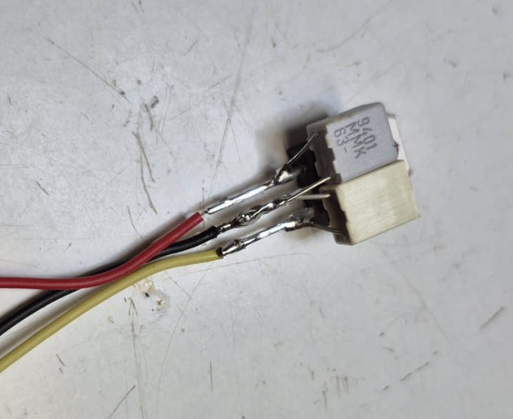

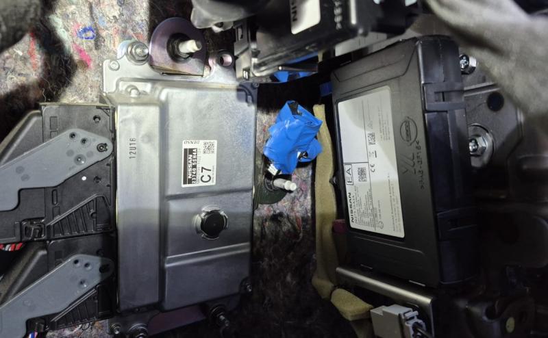

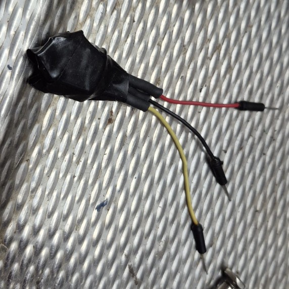

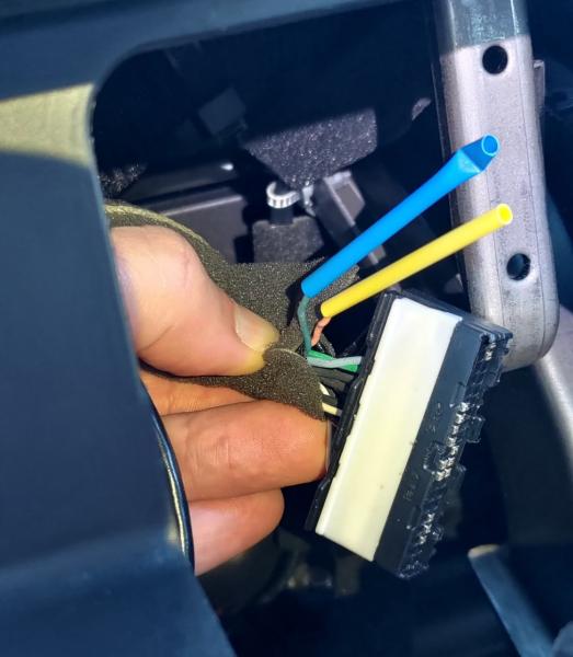

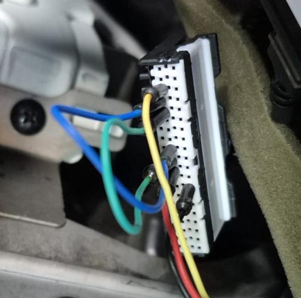

2018 ZE1 working TCU removal with microphone power 5v
post #7 mod is working ok.
First i removed the TCU module and confirmed, that microphone was not working anymore.
Then i build a 7805 regulation and connected the microphone lines. Quite hard to find appropriately sized wires to fit to the connector.and that electrical contact is succesfully made.
Then i just taped the connector with electrical tape so that wires are not loosen.
This has been working now for a two weeks. Some pictures to help other installers.
sasha
Nicely done!
Nicely done!
Did you power MIC from ACC pin?
electron
7805 is powered with pin 10
7805 is powered with pin 10 (Wake Up/ign) and 7805 regulated 5V voltage is conected to pin 18 (Mic Vcc). 7805 GND is connected to pin 28 or 29.
TCU-connector:
