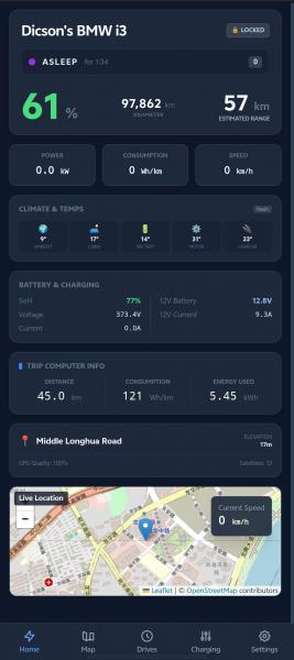

Hi Everyone, I wanted to share a project I've been working on called OVMS Mate. As a fan of the [TeslaMate](https://github.com/teslamate-org/teslamate) project, I wanted a similar high-quality, data-rich visualization experience for my OVMS-equipped vehicle (specifically optimized for my BMW i3 2014, but adaptable to others).
What is OVMS Mate?
It is a modern web dashboard that visualizes the telemetry data from your OVMS module. It separates the data collection from the visualization using a modern tech stack (Node.js Logger + Supabase + React).
Key Features:
1. TeslaMate-inspired UI: Clean, dark-mode interface focused on data.

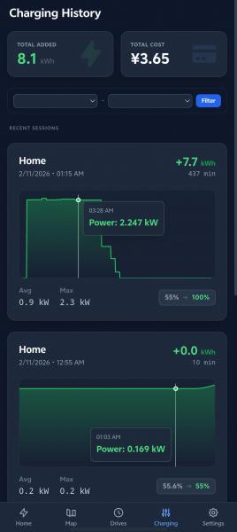

2. Historical Data: Logs every drive and charging session automatically.
3. Visualizations: Interactive charts for speed, elevation, and charging power curves.
4. Live Map: Real-time tracking with path tracing.
5. AI Analysis:(Experimental) Uses Google Gemini to analyze drive efficiency.
6. Passive Logging: The logger subscribes to standard MQTT topics (`v.b.*`, `v.p.*`, etc.) and does not spam the vehicle with active polling commands, preserving battery life.
